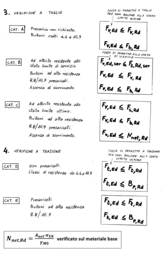

the bulkonato coupling is calculated according to uni en iso 1993-1-8 already treated many times on the forum.
if you use a friction mating you have not only to evaluate the traction on the screw.
The debate can be This is what with the formulas of the post #11 that I bring back below.
1705609018713.webpthe coefficient of friction you are obliged to estimate it, otherwise you have to make a tilted plane with the materials that you will use ....and the angle to which the block begins to descend, will determine the coefficient of friction. We've talked about it several times.
