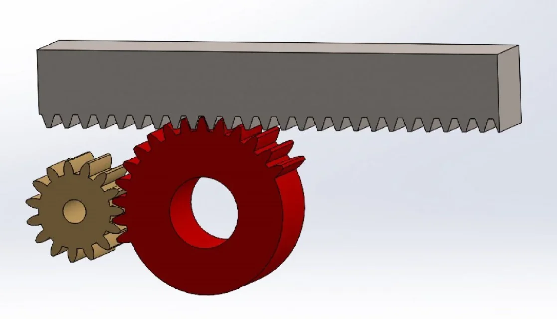

the problem on which I planted concerns the coupling of a rack with a straight teeth wheel.
the wheel is dented only by half of its circumference, while the other half is smooth.
Obviously the rack does not notice this (the coupling principle is based on other parameters, certainly not on friction between the teeth) and continues to move even when it is in contact with the smooth half of the wheel.
I hope someone can give me a point to get through this rock.

below an image of the phenomenon previously described:Assieme2.webpMy problem is that the rack moves even when it is in contact with the smooth part of the red wheel while I would like it to move only when it is hooked by the teeth.
attached the .sldasm file.
Thank you for any kind of contribution.

In practice I have to put a spring behind the rack. the operation must be similar to that of a softair gun.
I have to simulate that the spring is compressed by the rack until the rack is hooked by the teeth of the red wheel. when the red wheel loses contact with the rack, this is pushed forward by the spring as a bullet.
then the rack is hung up by the red wheel and the mechanism is repeated.
I must therefore be able to simulate the dynamics of this operation
you can also be able to simulate the movement of the rack by setting collisions (in theory) in the movement, but the spring will not be able to see it compress and dilated if not, perhaps, using the motion application.
Unfortunately, I think I haven't solved it. the video explains how to realize the animation of the spring but the movement "go up and down" works regardless and is not explained how to realize it?
I tried with the option detects collision but nothing happens
the video shows how to create physical simulation with motion. you cannot expect a video of an advanced function to explain all the modeling starting from the bases.
what you want to get you can't do it with collision detection because the spring doesn't change.
First of all, the spring must be created with relations to the other parts so as to be sensitive to changes in the hedge. a spring created without relationships will never change if not changing the values of the part.
so watch some videos of how you build the springs (spring returns more results) and you will surely find that they fit the asses.
That's true, too. Well, for now, I keep trying to find an enlightening example. thanks anyway for the passage
I thought it was the easiest thing to do right now.
Of course, there is no way to explain to the software the question of the semi-dented wheel?
I mean, it certainly exists, it goes to understand which...
