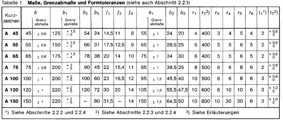

I am applying the uni en 13001-3:2015 to check the wheel with its track, specifically I have a flangeed wheel d.250 and a bourback wheel size a75.
the first verification that imposes the norm is that on the point contact or linear (see attachment), then saying that the point contacts are out of the field of application of the norm.
here arises the problem, i.e. if I admit the dimensional data of my rail and my wheel falls just in the case of dots, then it would not make sense to proceed with subsequent checks.
What seems strange to me is that the dimensional data is related to a wheel and a wagon rail, so I do not expect to fall in a particular case.
I also carry an extract of the din536 relative to the size of bourback profiles of form a.
thank you in advance to those who will answer.

in my case I rotate flat and burback profile.
I don’t feel so much about the fact that the norm excludes all the time contact cases, since the burback coupling with flat wheel is punctual in any case, and is normally used as a solution for the carriageway and crane routes.
