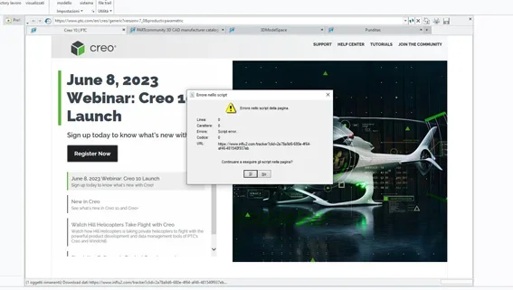

Hello, do you know how not to charge ste-page at the start of creo 7?
I always miss it and I have to click 2 times to let it go more even close the browser page that I don't care at all. . . .1.webp
Maybe I found it, I have to wait tomorrow to restart the pc but rebooting the creo now does not charge the fin of the browser.
file-options-sets window-sets browser
remove two flags
