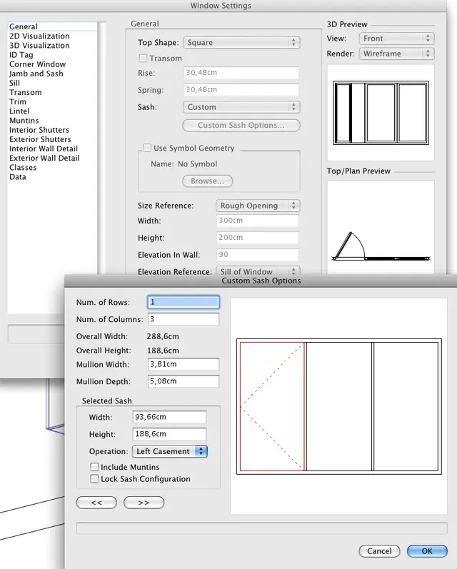

a curiosity: surely the lock "all glass" doesn't make much sense; to insert a lock with frame, etc. is the only way to create it with the mod. 3d or are there functions to model custom "parametric windows"?
to insert a lock with frame, etc. is the only way to create it with the mod. 3d or are there functions to model custom "parametric windows"? .
as you can see from the attached images, the parametric windows can easily shape them according to your needs. there are many parameters to get well detailed objects. but if you stay inside quite common types.
having special needs is better to build them by modeling and then converting them into symbols.

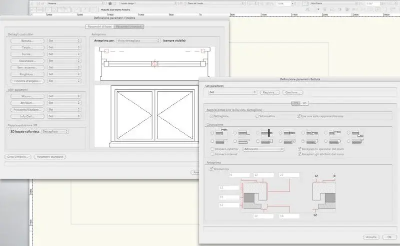

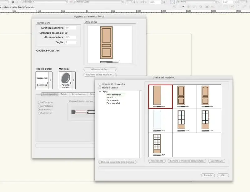

as lory.b has already written there are several methods to obtain "commun" parametric fixtures.
there are differences between the Italian version and the international version.
as the parameters of the locks, that in the Italian version adapt more
to our national parameters. see attached pictures
