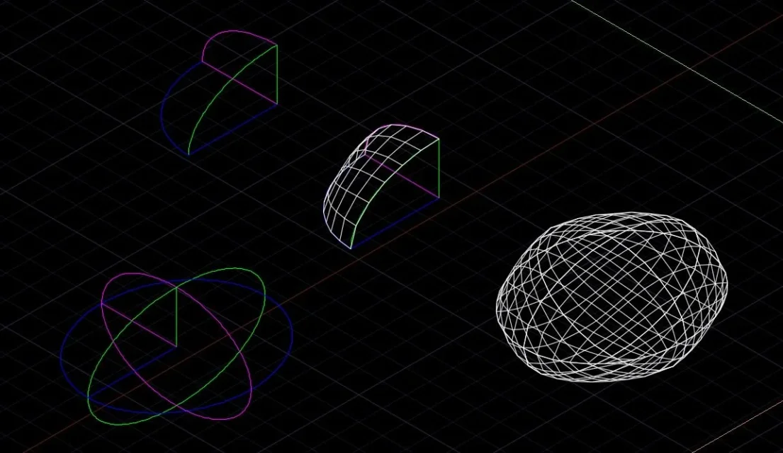

Good morning, I should create a solid 3d having a shape of a shiacciata and ovalized sphere in all 3 his axes.The command "sphere" creates me a solid 3d in the shape of a perfect sphere and I do not know the way I can then crush or iron it. then drawing the sections of the 3 profiles and using the command "_edgesurf" (o supcoon) I managed to create a mesh of a portion that then multiplied x 8 would compose my sphere. but at this point I can't turn the mesh into a solid 3d. How can I do that? Is there any other system to be able to create my 3d solid, then to be modified and worked further with any Boolean operations?? ? Thank you for your help.

creates the ball with the ball command that is located in autocad mesh, increases the smoothness of 4 degrees, uses the gizmo scale to crush it along a board and then convert it into solid.
Okay, that sounds like a good system. simple and effective! tried and works. but if I had one of the 3 sections (the colored one in purple in the photo) different from the others (with straight lines) and I have to get to the final result of a spherical form - squared as in photo (built dempre with the command "_edgesurf" ) how do I transform it into a single 3d solid object (they are 8 different mesh) however editable then with Boolean operations? Thank you for your help.
try to use loft
generates sections along a board and then from a loft between sections.
to refine more the object creates another loft along the perpendicular axis, overlap the two objects and the command interfers, specifying that you do not want to delete the resulting solid.
or create a sphere, make a block and then with the property panel only change 1 axis (type axis x ->0,5). But know that after the block it will no longer be unexploding.
