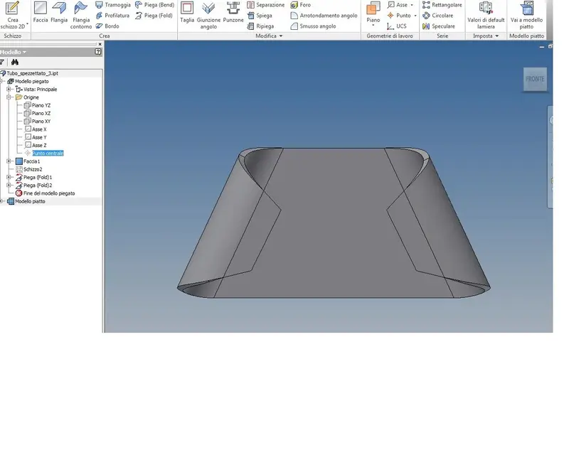

mah, I tried to realize it and it seems quite similar to the photograph of the first post (to which I was inspired), of course it is not identical, but the form seems quite similar to me.
I had difficulties at first to understand the correct approach and after trying in various ways, including with the command "tramoggia", I tried with the command "piega (fold)" with a line I realized the bending starting from an open model.
Of course I have done it entirely to the eye without any claim to have something perfect with random measures and without quotas, but I believe that, if you want, you can put quotas and precise measures.tubo_formatore.webp
