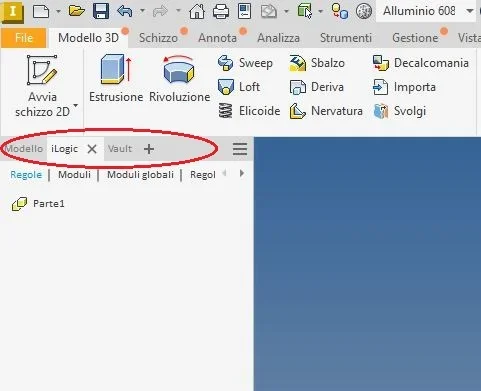

good start week to all,
I have a question for super experts.
Does anyone know how to create custom cards?
Thank you!

It's a topic I've never looked into, but I remember that in the help I saw this:
Code:
sub dockablewindow()
    dim ouserinterfacemgr as userinterfacemanager
    set ouserinterfacemgr = thisapplication.userinterfacemanager
    ' create a new dockable window
    dim owindow as dockablewindow
    set owindow = ouserinterfacemgr.dockablewindows.add("sampleclientid", "testwindowinternalname", "test window")
    ' get the hwnd of the dialog to be added as a child
    ' change this value!
    dim hwnd as long
    hwnd = 4851096
    ' add the dialog as a child to the dockable window
    call owindow.addchild(hwnd)
    ' don't allow docking to top and bottom
    owindow.disableddockingstates = kdocktop + kdockbottom
    ' make the window visible
    owindow.visible = true
end sub
I imagine you've already found it, but for a sculptor. . .
I think there's something useful here, too.
ciao @catcher, yes I found the example, I'm doing some evidence.
thanks for the additional material.
I'll have something to study in the next few days.
