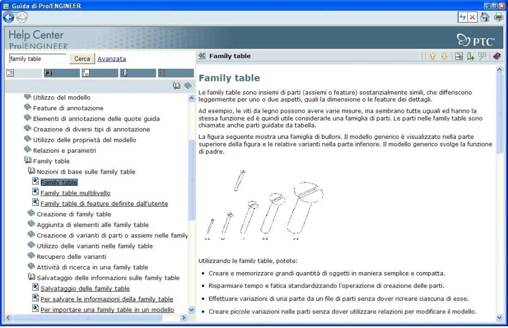

the ft (family table) method is used to have all the variants you want or a model or a set. you can manage quotas, features, parameters etc. at will.
for details try to see the online guide, which is not hurt, or do a search in the forum. If you need further clarification, make a whistle.
