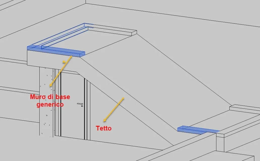

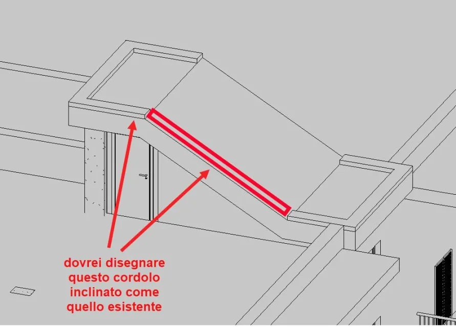

Hello everyone, I should draw the tower of a sloping building, only that I can't draw the sloping concrete cord, you see the photo and you will understand better;) . tips on how to do?

bye, you could try to build it as a cls loft by acting on the inclination.
Mature
that highlighted is a generic base wall

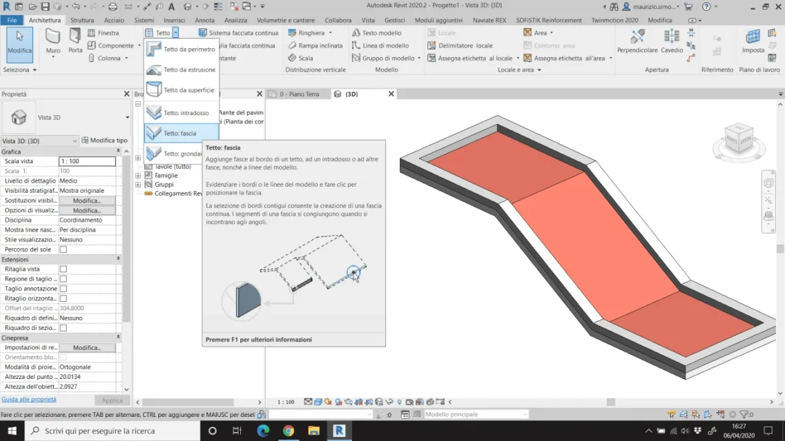

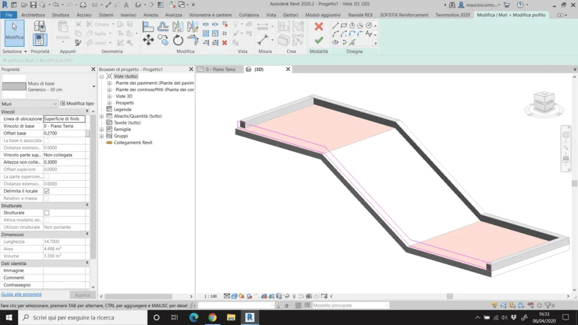

If it is a roof you can use a band or railing or if you need walls, use profile change
