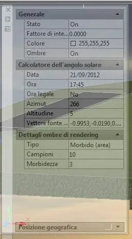

would be to understand how you set the lights (sunstatus and skystatus on or off) and how did you set the rendering (fg and gi activated or disabled?) as well as give, as it rightly says gil, a ritoccatina to the materials
about alone and sky I hold them both in position on (I also annexed a jpeg with sunshine). about fg and gi unfortunately I'm not sure... I don't know what features they are. if they match "filter and gizmo" then I set: "No filter" and "gizmo move".

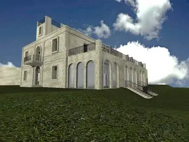

I think I have improved the prospect a bit by changing the mapping and intervening on the texture by changing the colors. now I will try to improve the lawn and the background. place also the values of gi and fg (now I know what are:biggrin:)
I feel so much better. decrease the scale of the texture "grass"
tomorrow I think I will post the render with the changes you have suggested to me, then I will try to work again on fg and gi and on the background:finger:
Okay, sorry for the delay. I slightly decreased the scale of the grass texture and added a file for the embossed composition map generated by crazybump. However the grass is not very embossed. during the generation of rendering, when the grass is seen as a draft, it clearly sees the grass in relief, then, when the render becomes defined this returns to be flat. ...boh! in rendering you also see glass, but on those I still have to work. Some straight?
