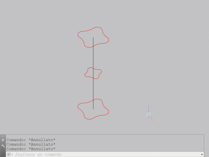

this is the column with constant section, I need it to tighten to half height and return to the normal section on top.

The only way that comes to mind is by means of a loft of sections. more sections are more accurate is the result.
In fact, in the "scale" sweep option there is a sub option "expression", but I do not find explanations about its operation.
the system you used I think is right, maybe you didn't give a proper scale factor to me in principle works.
good idea the loft of sections, but I can't imagine how to get the correct sections "stratum per layer".
in that way I managed it too, and it is also simple, but so doing the profile of the column follows a straight line tilted up to half height, then it changes angle and continues always straight, to me it would need to be curved, so " )( " and not " v "
(I hope my hieroglyphs serve to make the concept... ) a
[Cristallo's method]- copy a profile in half height and one in top
- the half-scale one of the desired factor and rotate it by 45 degrees
- creates two splines that serve as guides
- loft with "guide" option
As always you have the solution under your nose, but until someone shows you.. .
and I who was going to get me to think about who knows what unknown command! !
Thank you so much!!
