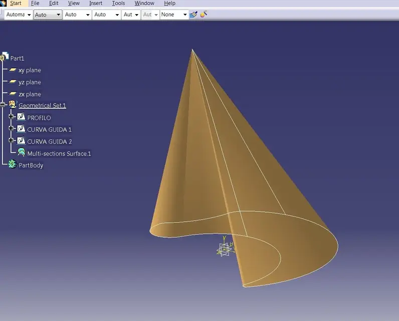

I used a loft with section (only) starting 'irregular' trying to make it look like yours.
I added 2 guide curves (two lines) to govern the passage from section to final point. you can add as many guides as you want
of course, the more you go to the tip the surface degrades (loss the internal tangences). to ovviare you should add intermediate sections of control and more curved guide.

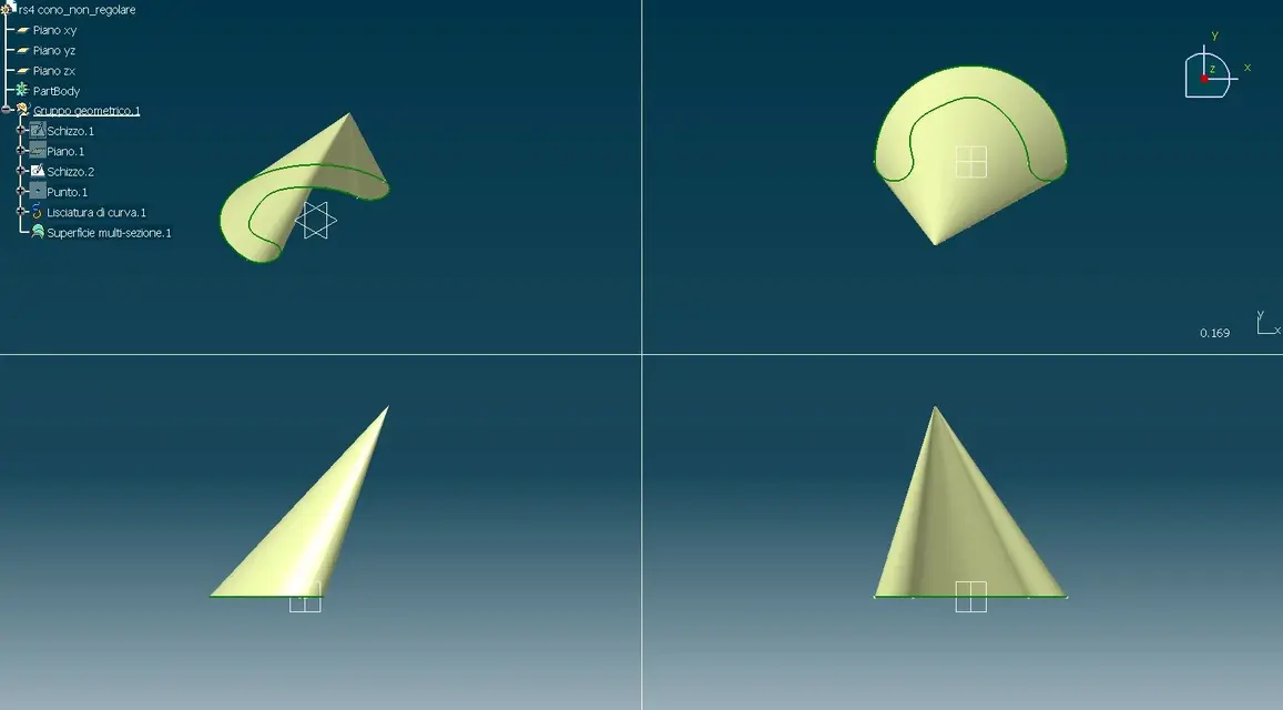

Hello Dalm...
I think you want something like that. .
I would say you don't need guides but only sections and closing points that coincide with each other and the game is made
I'll train you
greetings
