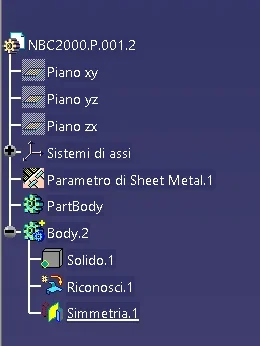

thanks dalmott, it worked, created the new part, put the parameters of sheet metal, copy of the body part "father", paste special in the new part by selecting "as result with connection".
I had to do the plate recognition by clicking on a surface, then I made the symmetry.
In this way I have the daughter part speculating to the father part, making a change to the father part, automatically reflects on the daughter part.

1697530245480.webpYes, the icon is the same, but after entering the body, if I try to make the symmetry I give this message
the icon under your body.2 is not equal to mine, with the sheet module you have new ways to paste with connection (try the last of the first picture)
