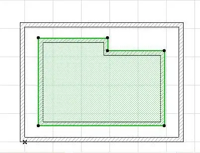

I tried to draw the loft with archicad but it makes me insert it as if it was a single surface, I can't find an option to exclude the central part.....
as you see from the attached photo, the green part is the basement floor that is located at altitude -1.70
the white part between the two walls is instead the insole of the wholepedine which is at altitude -2.10
I have to insert the ceiling of the intercapedine

very simple then. make the big loft, draw the contours of the smaller one. click on an external loft point and click on the "-" symbol. by pressing the space bar click inside the closed line with which you have designed the inner ceiling.
At this point you have a loft with the hole inside!
by selecting again the loft tool, and with the magic wand (always space bar) and by clicking you get the new loft. at this point you just have to give the right odds
