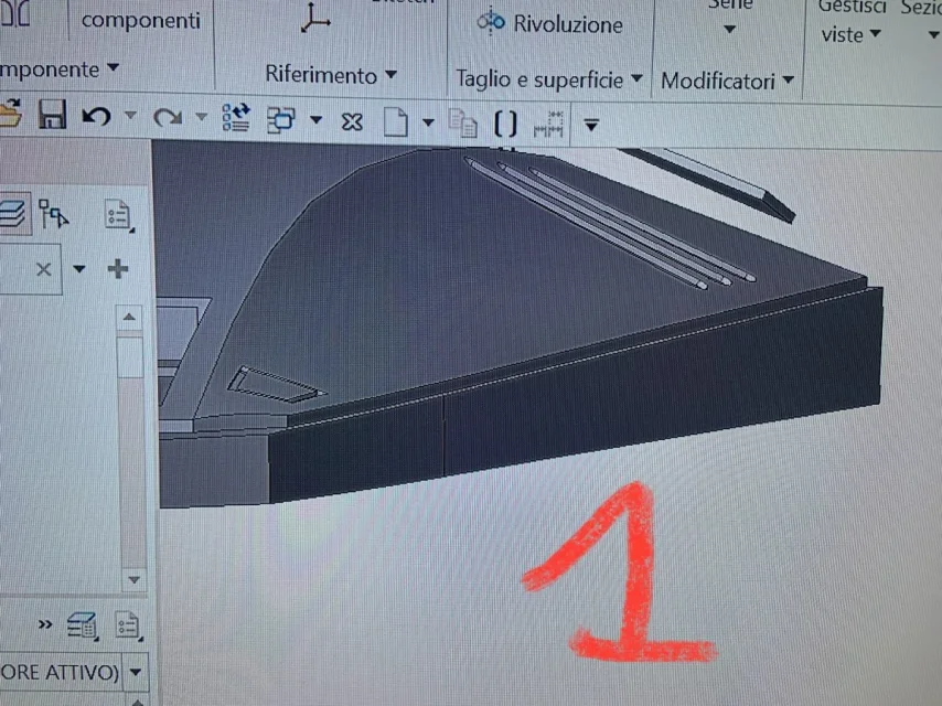

IMG_5768.webpGood evening. My name is ignatius. I’m not new to the forum, I participated in some discussion time ago then for personal reasons I’m a little bit detached....now I’ve resumed and I’m using “creo” to make pieces for modeling on my own. I ask politely if someone can give me a tip to remove material (indicated with red point), from the tilted side indicated as “1” of the attached image. with the projection function I created the profile. with “sweep” I can only remove the boundary of 0.5 mm wide. If I go wrong.... is there a method that I do not know to make a removal of deep material 0.5? I hope to have been clear thank you very much. greetings
Hey, I don't know what you're doing.
is it a solid part or sheet?
the removal of material must be normal to the tilted face or to the underlying plane that you see?
You want to remove a "solco" along the perimeter, right?
hello it is a solid part. the removal of material must be normal to the tilted face and I do not want to remove only a groove around the perimeter (which I have actually already done), but also all the material inside the groove....if I raise the section of the groove to the inside of the profile, the system gives me error and does not remove anything thanks thousand
I wouldn't use a sweep.
try to create a material subtraction extrusion directly on the face, which uses the profile you want and to which from the desired depth.
IMG_5788.webpIMG_5789.webphello first of all thanks to the availability ....the surface as you can see in image 1 is very irregular (it is not that you understand so much but it is so). if known in image 2 I managed with a straight line projected on the sloped surface and using the blend sweep to get something that I will settle for, but I would need to tilt even the upper and lower sides indicated with the arrows....and here I block grazie水 grazie thanks ’
