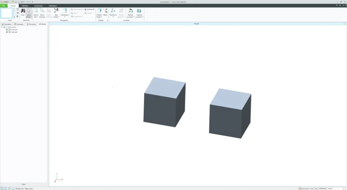

try to make a set composed of two cubes, look how you see: If you still see badly you can zip and attach it here.

I tested how you told me and it seems to work
