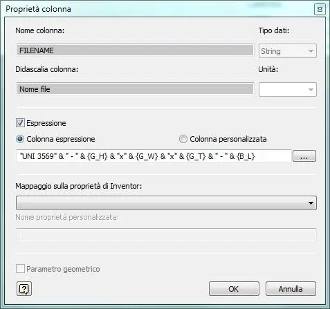

in the family table I tried to change expressions to make the profile
imported is already saved with your data (eg 20x20x2 ok) plus the
length for each imported detail, but the latter always remains 0.001 which
would be the minimum inserted by me in the variable length expression. I change
manually to save files, but something wrong in settings. In theory
the information with expression should be blue, but just made the
changes are blue, then become black. I hope I've explained clearly. .

in the family table, if they select columns of expressions on uniso,... the
columns are blue, apart from that of the material, in my custom library
columns with expression (dimension, length, designation,...) were blue when I
inserted or modified the expression, then became and remained black. If you're not
I add a new line and change value to width, height, thickness, all
columns update automatically, the part inserted in the drawing is right and
So I think it's okay.
when save the profile file inserted from the content center -es: "...-20x20x2 - 0.001"-, 0.001 should be replaced by the new length set by me. after a few tests I realized that if in the family table the columns of the expressions are blue the length is varied in the file name, if instead these are black is not replaced (as from photo).
the fact is that after the changes in family table when I do apply and ok everything comes black. Can it be an internal problem to inventor?
