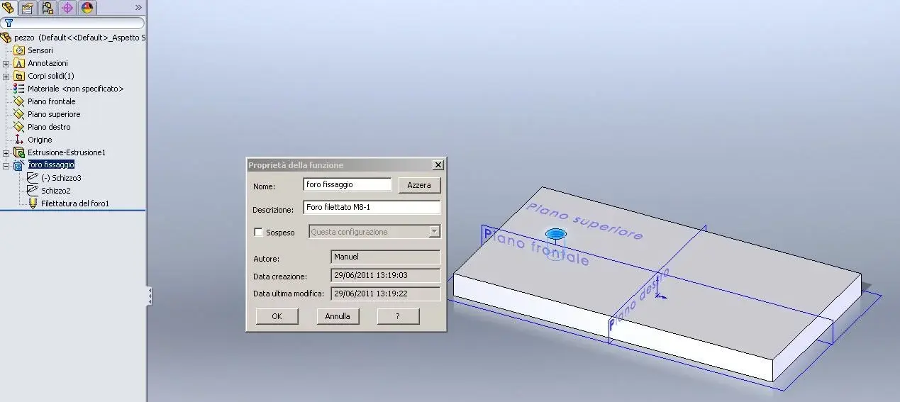

I would need a hand to customize the holes table:
by request of the company you want that in the table holes in addition to the dimensions and references there is also information on the purpose of the holes. (Don't tell me it's absurd, please): )
However, to solve the problem, two possible solutions have come to mind:
the first and easiest I think, is that since I can change the name of the function that generates the holes (see image) it would be enough to make the name of the function that generated the hole in the hole table in a new column
alternatively, but it seems more complicated, it would somehow add a property to the functions of the holes and then this appeared in the table.
Does anyone have any idea how to achieve one of these solutions?
or if you have better ideas well come!
Thank you:
I tried to rename the function in its properties but then in the table put always puts the original name even if I add the variable of the name of the function. I don't know why. sw2011x64sp2.0
Would you explain to me how you put the variable in the name of the function that I feel?
I'm already changing in various ways the callout file, realize that they wanted me to change the depth symbol (the arrow down) with a "x" because it was not clear... It won't take long to understand a symbol! :rolleyes:
do caption hole and quoti normally. click on it and variable premiums.
in sw2008 I can't put them variables, I don't have the "variable" button and even putting names (lost from your image) are considered as simple text.
