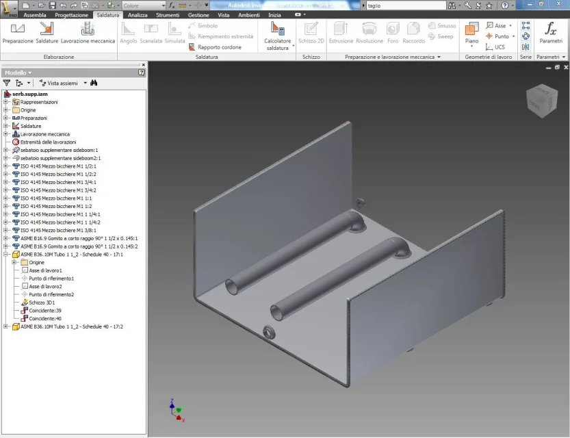

Hello.
Yes, it is a stupid question but I can't find the solution I have to make a cut in "salame slice" on the tubes you see in the photo but I can't make them, they are in an environment together and the pipes I have inserted them from the contained center!
Can you help me?

a structural component inserted by cc, becomes a normal ipt (or almost).
if you have to change it: in the browser right click on the tube you need to cut ->open,... and work as you want. .
Thanks tarkus, my problem is that I do not know the procedure to make the tilted cut!
Wow. do a sketch, draw 3 rows in the shape of a rectangle triangle and use it to make a cut...
Wait, don't warm up:smile:,maybe it's really the first weapons.
First of all, what version of inventor do you have? If you have 2013 (maybe write it to profile) I can post an example file.
second: Can you make a plan along the axis of your pipe?
If you can do it, as mbt says, do a sketch on that floor, project the edge of your tube and draw a triangle where the tilted side is the profile of your salami slice.
then extrusion of subtraction with direction from both sides.
or, always through sketch, creates a tilted plane and uses the command "divid"
I'm not getting hot. .
But if I see that he's capable of doing the box and pulling up the pipes, the very first weapons must not be and so I'm amazed at a question like this!
You're right here.
Thanks for the help and advice you gave me, I finally managed!

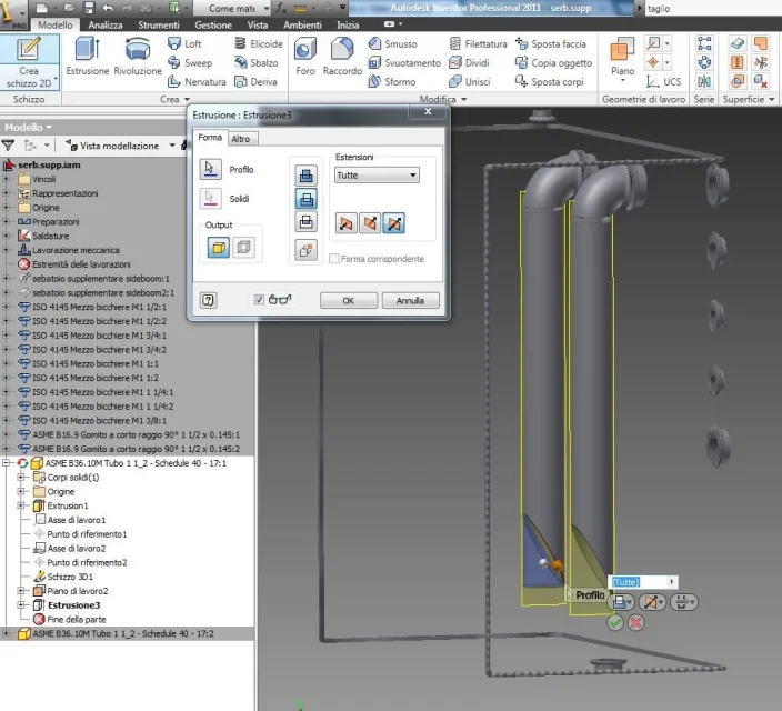

I ask you another thing, if I carry out holes as mechanical processing in a sheet inside a set, as I can see them in the flat model of the single part

If you do them together you don't see them in the flat model. If you want to see them, you have to do them directly on the side.
you can't, the work done together doesn't reflect on the parts.
But you can get something like this:
together open (obviously), side file where you will make the hole sketch closed.
double-click in the axieme browser on the part to be drilled or dx-> change.
in this way you work on a single part directly from the assieme while remaining that you can project the edges of the other parts you have together.
if the part that you holes is a sheet will see the holes also on flat model.
But you still do some work on part and only one part at a time.
But do you really need to get them together?
As a rule, only those processes that are physically done together on coupled parts. . .
