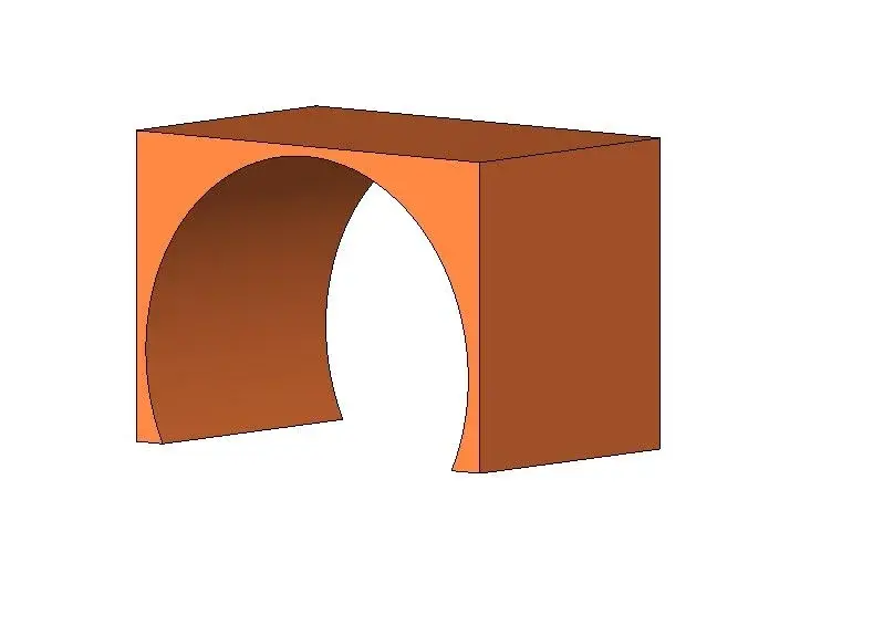

I need to make a great opening in a standard wall.
then I modeled a place wall consisting of a full rectangular and a circular vacuum that goes to dig.
only that now I don't know how to insert the molded wall with the standard one already inserted
This is the shaped wall

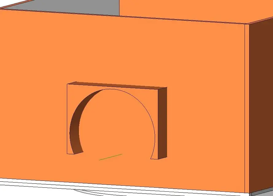

muro.webpand this is the result of the insertion
immaginev.webpHow do I solve this?

1 solution.
insert the vacuum directly into the standard wall and then draws the frame, using the contour of the vacuum as a path (extrusion on path)
2 solution
using the molded wall (from you created), you must perform a vacuum even on standard wall
3 solution
make a family based on wall, with frame and vacuum, which will be automatically created (frame+empty) to insert the family into the standard wall of the project
