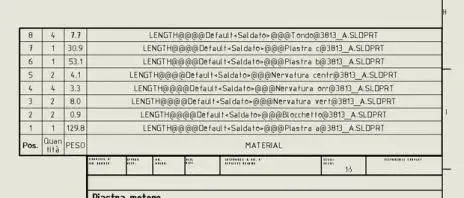

on a multibody side I want to get a material table with various sheets, plates, rounds etc. that compose it.
to make this rub the cut distinction and create a table custom cut list (.sldwldbt) with items q.tà, pos., weight unit. and material.
the problem is that in the table there appears instead of the material a string that refers to the length.
on the model the table is correct. (see attachments).
Can anyone help me?
Can anyone help me?
to help you I should install 2010 and make some evidence. have you already used that table in other versions of solidworks? Are you sure you made it well?
to make a test I could give you a welded part and a table pattern and you could try using it with swx 2010....
for now I remain on 2009, now I have a certain confidence with the bugs of this version and I'm sorry to leave them to know about others, so I expect another little.
I do not have a great experience on sw but the fact that on the model the correct table leaves me very perplexed.
If you send me a welded part and a table model in 2009 I would be grateful.
