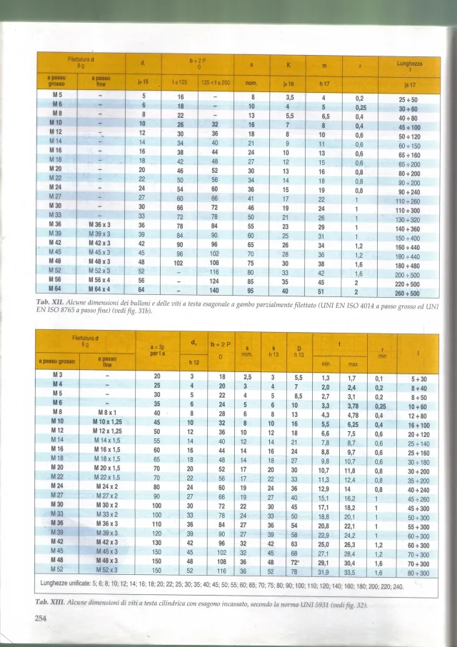

as from title I would like to know if there is someone of good heart who could communicate the size of the seats for the cylindrical screws with hexagon recessed (uni): m14, m18, m22 (in other words the 2 diameters and depths of the lamature).

very likely you have to find the size of the specific cutters
that make the quarry of the tcei m10-12-eccc
or look for brucola
generally the diameter of the quarry is +0.5/roy
depth decides the designer
according to his needs

dovrebbero essere queste.
