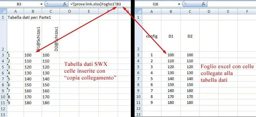

I am using swx 2013 sp5 and excel 2007.
in this period I am making data tables whose values are convenient to be taken from a series of excel sheets with the function "link copy"
I found this problem, which I had met in the past and circled brutally not using the "link copy" function:
when the data table and the excel sheet are open at the same time if I turn the columns connected to the data table they are updated on the data table as it was an absolute link.
on the contrary, if I close the data table and in the sheet I choose the linked columns, when I reopen the data table the references remain to the previous columns. I don't need to tell you what kind of inexorable mess can happen.
is someone aware of a possible solution to prevent the connection being lost? I attach two images for more clarity, excel and swx files for those who want to do tests. I have no idea whether it depends on the old version of excel, swx or both.

What a beautiful bitch you came out of the cylinder:
I've been dismaying for a while to try to solve it with excel's functions.
the solution is to use a function that searches for column d1 and return the corresponding value.
the forum is as follows:
=cerca.orizz("d1"; '[prova link.xlsx](ref.riga()-1))
the variable (ref.riga()-1) returns the value corresponding to the current line and serves to copy the formula in the next rows without having to manually edit the reference; the -1 must be put because the search for the value d1 excludes the header. .

I tried now and works perfectly by moving the table anywhere within the selected cells as a range in the function. I just need to organize excel sheets of data origin by coloring the columns or identifying them somehow to remind me that they are connected to the data table and that I do not need to rename the column header.
