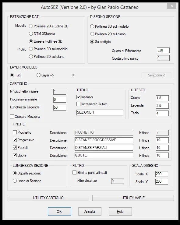

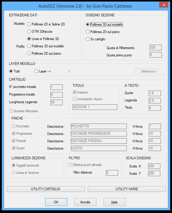

Good evening!
I have been trying for a few months with dcl, and now I would like to be able to disable some of his parts, in a few words this, which happens as an example in autosez2. .know what function is, and how does it apply? I have searched on the network of similar functions, and various tutorials, but nothing... below the example:esempio1_non attivo.webpesempio2_attivo.webpThank you in advance
to disable via code you must use mode_tile
(mode_tile "key" 1) for "key" means the key to the element to be deactivated.
ciao! non with us quel command, io ho always usato questo:
Code:
(dcl-control-setreadonly punching/punz/c2 newvalue [as Boolean])
What do you mean, equivalent?
if you use opendcl I think so. for the simple autolisp/visualisp you have only mode_tile
