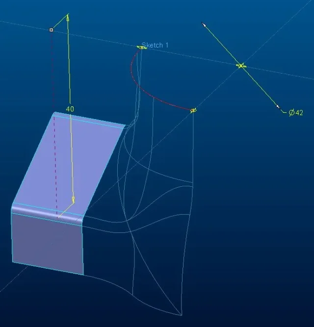

hello to all, I have to design a piece that will be made for molding and to do this I ventured into modeling for surfaces. I started with defining limit curves (by sketch or by point curve) but unfortunately given my little experience I can not get an acceptable surface.
I put the model I created with I create 1 in hope that someone can help me even with advice.
p.s. for reasons of symmetry I worked only on 1/4 of geometry because once I created the surface that I need the intent is to make mirrors and merges to get to the whole piece.
Thank you, a greeting
you can't do boundary blend mainly for 2 reasons:
- the tangency/normal edge conditions are not congruent with what you want to achieve (the sloping sketch with conical radius 0.4 and the 2 profiles on the Cartesian planes cannot create a "soft" surface)
- you have to try to split the patch you want to do in a few areas with 4 boundary curves ( easier to say than to do)
If you give me a few tips about how you'd like me to try and make some sense. to do so I would need to know:
-The sketches on the reference planes have that geometry for a specific reason or have you hypothesized them to make the patch correct?
-What are the floors on which you would mirror the surface to get the finished piece?
-The two sloping surfaces that form a living edge can be collected or should remain like this?
hello, luca, thank you very much for the interest.
First of all, what I would like to achieve at the end is the fitting of a three-way valve modeled with a somewhat warlike and presentable surface (not so...). 0958_03022015.webp
the sketches that I would like to keep as contour are:sketch11001_03022015.webpsketch21001_03022015 (2).webpsketch3 (not binding)1022_03022015.webpand if possible (for aesthetic reasons) I would like to be able to control the geometry ofsketch41002_03022015.webpsketch51026_03022015.webp
mirroring floors are front, right, e top
can be collected
I also attach the updated cad file.
Thank you very much, a greeting

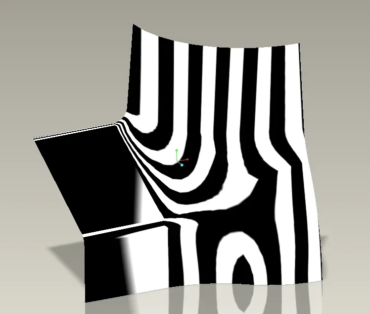

Honestly, I did the job, and I took off some curves.
Everything is perfectly tangent even when you mirror.
I think you have to create before the surfaces, letting it be arranged (poke support curves)
and then after you found the closing of the tangences you can add more for greater control.
I didn't read everything you wrote.Cattura.webpCattura2.webpRemember when you create the blends to select the edges and corners intent, not the curves or sketches otherwise you will never get tangency.
also uses control points to decrease patches.

Try to do that. put in the surface unions selection filter.
then select the surface and make mirror.Cattura.webpthe concept is that it mirrors geometry, not features as it was said.
