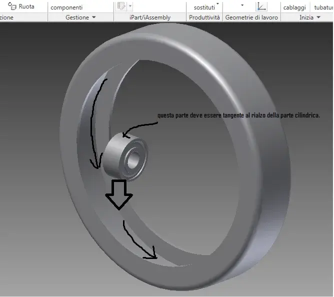

Good morning, I just signed up and I don't even know if this is the right section... I have a problem with inventor 2012. I should bind a bearing to slide along a cylindrical guide as I can put a photo at least you understand better.
In fact all a tangential bond between the outside of the bearing and the inside of the rolling track, then a bond between the half-carry of the bearing and the half-carry of the guide.. .
hello tarkus thanks for the answer. I tried to put the two constraints you told me nothing didn't work. When I take the bearing, it moves parallel to the floor with which I have bound it in halfway and I do not remain closed in the cage. :confused:
mail the file...
thank you so much for the interest...I finally managed...I coupled the tree that went into the bearing at the center of the guide with alignment axes, and finally a bond of tangence between the inner face of the guide and the outer one of the bearing.:finger:
