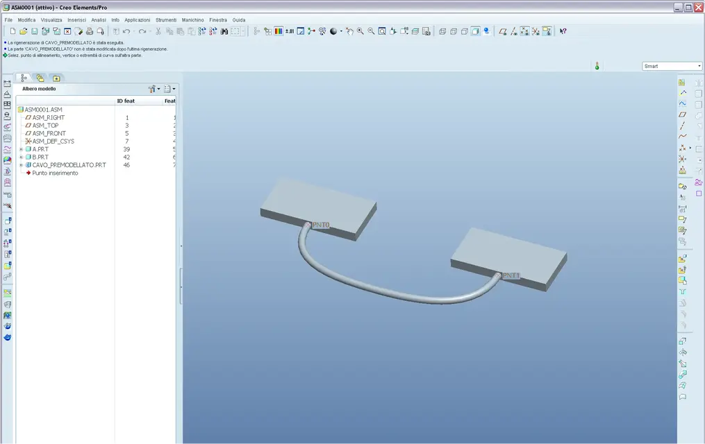

Good morning to all, I looked in the various forums but I did not find an answer to this function that I think it is possible to do with proe wf3 .
I'm pressing that my reasoning is electronic, so it could be an obvious thing.
I have the need to realize some conenssion drawings of electronic control units for the control of led we produce and I would like everything to be done by the 3d having of these the complete model.
I assume to manage the import from the ecad for which in the electronic cad drawing the model 2d of the details then I carry it in idf and then load the relative assemblies 3d from proe.
the result is as from attached file, only the cable that goes from a green connector to another green connector (for clarity I put 2 points one on the starting point of the spline and one on the arrival point)
If I design the cable in the together no problem, but to do this I must then solidify the whole by taking the trajectory from a surface and this not all my technicians know how to do it.
I would also like to import the cable already made and then in the whole tell him that this component 3d "cable" begins as the first point of the spline on pt0 and the final point of the spline is on pt0 of the other connector.
I didn't find a way to do that. I looked at relationships, could anyone suggest a solution?

since then I don't have to produce cables (I just need to represent them to clarify the various connections in the data sheet of the power stations)
I don't have a cabling library, or at least I could have it and then place the component in the electronic cad and via ecad as it happens for the various details to find it in the set.
and here I arrive, the problem is then that I would like the length of the cable to adapt or alternatively I would also well be able to adjust it I move only the starting constraints (pt0,) and arrival (pt1) and moving the points of any folds letting it automatically calculate the total length.
If I make a predetermined cable however random and put it in the proe assembly allows me to bind the start of the cable (I tell him that the pt0 points of the connector and pt0 of the cable are coincident), but then it does not allow me to make the final point of the pt1 cable to the pt0 point of the second connector.
if obviously the design from scratch in the set I can set this bond initially.

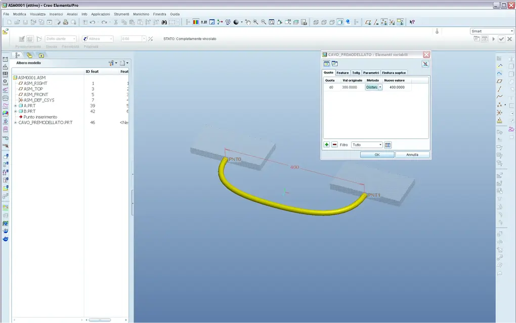

exact this is a road, that is to draw the cable by taking the final points of the connectors, or you can use the flexibility having already preshaped it, this scheme with the clearly simplified components.
1-draw the spline of your cable as a separate part and ties the 2 extremes on the previously created pnt0 and pnt1 points.
cavo premodellato.webp2-assemble the cable using the 2-points on the 2-points in the connectors, using the automatic function, will put the point-to-point bond on both.2.webp3-rend flexible in combination mode (set dx tree model - make flexible) your pre-modeled cable, taking as a method the distance, and do a distance analysis between the 2 points in scope together, so by letting the distance of the two connectors to your cable, resulting in extension-coupling of the cable, from you can extrapolate all the values you want, like the length of the cable and you can clearly create a family of cables.3.webpI hope to have explained well I have little time excuse.

In fact, you should have the flexible part, but this can only be done after placing it.
no, quiet, if you set the flexibility on the part, at the time of inserting into the proe axieme asks you whether to insert it as a rigid or flexible component. ....
choose "yes" and define how you define your flexibility. . .
