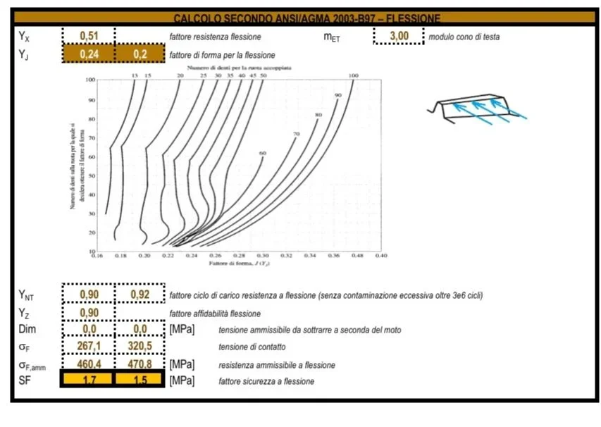

good afternoon, I am a mechanical engineering student I am carrying out a thesis under construction of machines and I have to make a calculation sheet with excel concerning the design of straight toothed conical wheels using the agma regulations.

on the shigley's mechanical enginering design find everything you can miss, being a manual of Anglo-Saxon origin.
for what you lack of geometry you can use niemann elements of machines 3.
at the end after you have calculated the various geometric sizes steps to the calculation of resistance/duration and you can make a calculation excel like this:Screenshot_20201029_200806.jpgScreenshot_20201029_200827.jpgthis is the result of a conical couple z1=20 z2=40 m=3 b=22mm pressure angle 200 and input 5kw at 1000rpm and the axes placed at 900 among them in 18crnimo7-6 cemented and hardened.

Unfortunately, no... because it's part of a very big project and it turns out complicated.
But I gave you all the information from where I recovered the formulas. ..just put them together and get a working spreadsheet.
