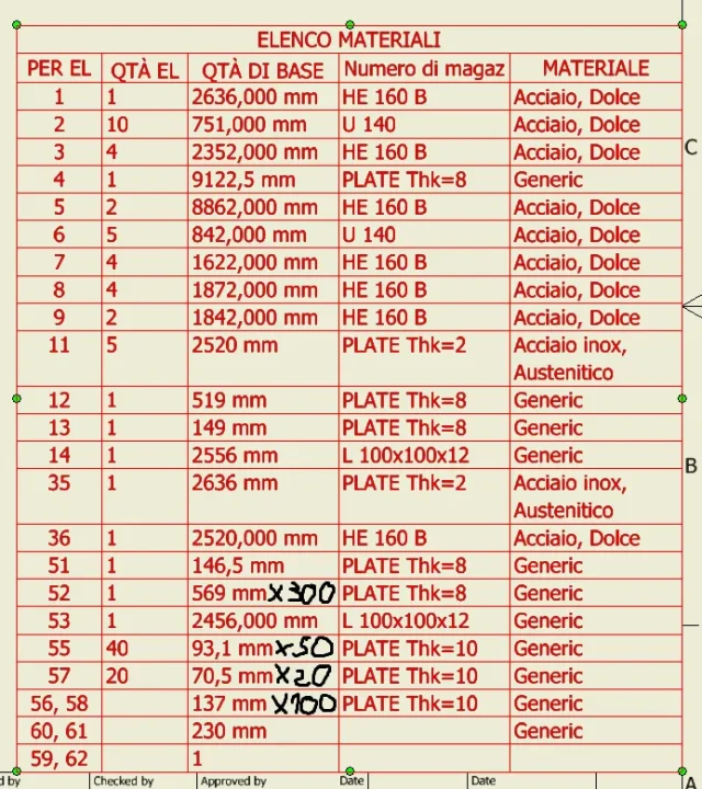

good morning to all members of the group, I am trying in a totally new carpentry project for the company in which I work and for simplicity I am making a separate cut, only that I have the following problem.

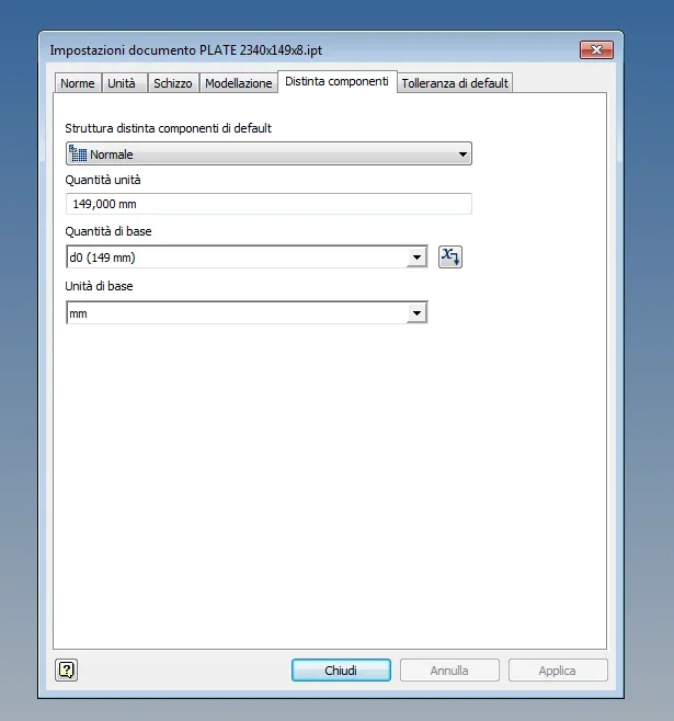

for the realization of the sheets I use the .ipt files but in the creation of the cutting distinction I can indicate only two sizes, the thickness that I insert by hand in the ipropietes under the heading number of magazine and the length that I insert in the settings document / distinct components. I would need to also insert the third dimension (width) always within the same voice.

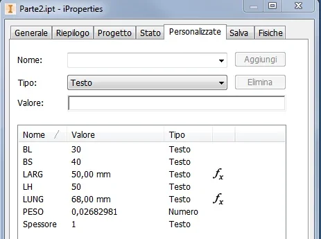

you can also create custom iproperties that read parameters without switching from document setting1627645449452.webpcreate custom iproperties and read value through variables.

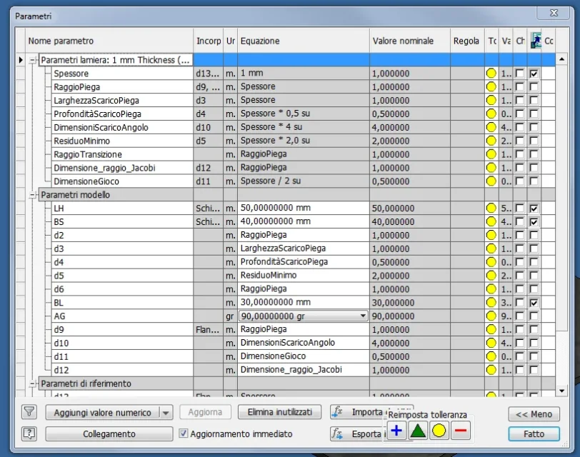

attention, sheet values.... represent the size of sheet metal development
for thickness, the value must be exported via fx parameters
1627645639857.webpwith the dx button above the value, you can decide how to export
1627645679938.webphere is the result1627645743668.webpwith the same concept, you can rename and export what you want1627645799416.webpeverything is passed and updated automatically in custom iproperties, which then, you will go to recall in the distinct

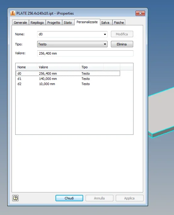

I thank you enormously for the time you have dedicated to writing the answer but this method I already knew,
I better explain I would have liked to use only two columns or one for the thickness (and so far we are) and another where to insert at the same time the width and length.
I come from solidworks where you could do, with inventor I am not very familiar.

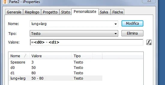

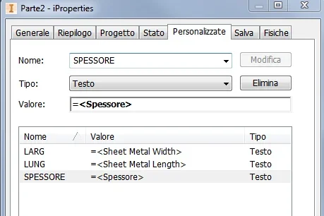

allora puoi sommare i due parametri ??
=<sheet metal="" width=""> - <sheet length="" metal=""></sheet></sheet>1628237015164.webp
1628250679850.webpfx key automatically appears if you enter a formula
to recall the formula you need to write "=" without apicetti
to recall the variable, you must put it in brackets - symbol "<" and ">"
then:
name parameter untente "lung+larg"
value: ♪<d0> - <d1>result = 80-50
Hi.</d1></d0>
perfect thank you I managed to make it work but I can't "transfer" it on the cutting list... .
Could you help me?

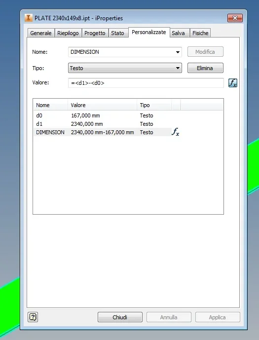

I have inserted on the custom properties the item "dimension" within which I entered the function =<d1>-<d0></d0></d1>Immagine.webpI went to the table open the list of cuts and created a new property by always calling it "dimension" but on the table I find no value.
a.webpThank you and good evening.
you have to click on the "new property" button and add size; clearly the list templates must have the parameter in each individual file
