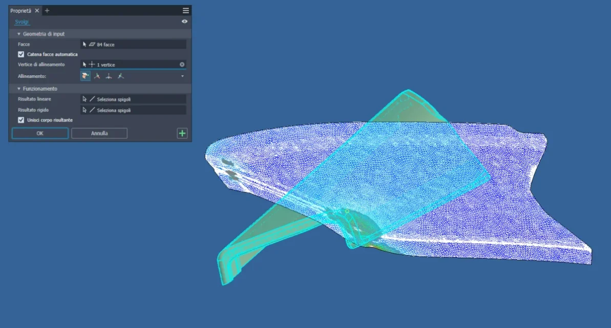

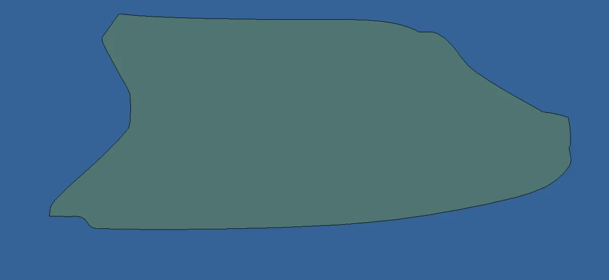

Hello fabietto,
I use inventor, the command equivalent to that used by biz is called turns and creates a surface... in practical use so far I have never used it even if a couple of times I would have been comfortable for indicative developments of unspoilt plates, but it goes back to before its implementation.
However at this point I am curious and ask biz if please can compare the results (I attach the dxf of my result) to see if there are significant differences between the two engines.
