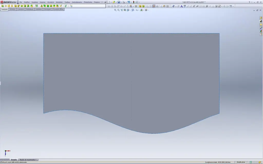

Of course the software does and develops it:TUBO CALANDRATO.webpTUBO CALANDRATO SVILUPPO.webpAnd we'd miss it.

Thank you very much. Does the software export it to me in dxf format? One more thing. Can I also decide the starting angle? in practice the welding of the calandrated durums should be performed on the shortest point. I don't know if I explained.
Yes, of course, saved in dxf, dwg.. and several other 3d and 2d.
decide all the corners you want in space as you want.
the joint line you can place it on any generator anywhere in the corner round.
