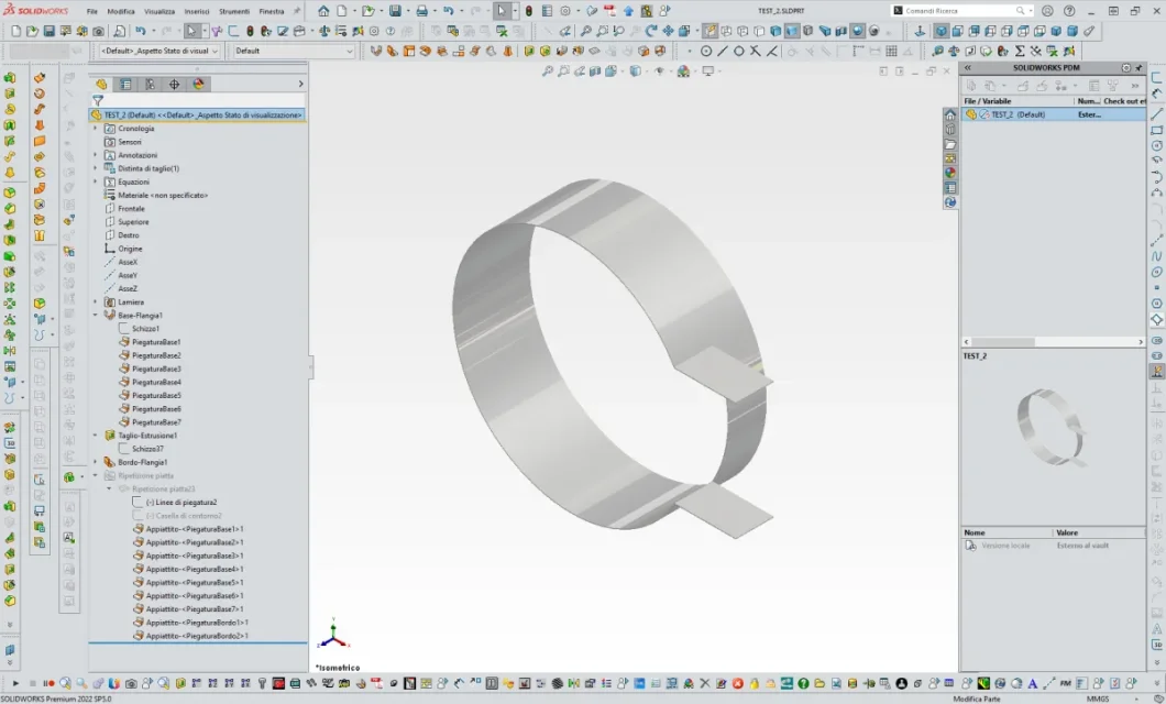

then I did so, some clarifications:
-you have to calculate the degrees well to have the legs folded at 90°
- as you see are two bodies so the development you must then compose you (make the two developments then join them on the obvious table that is a barbaric), solid "can't" to develop two divided bodies, if you join the bodies then can't do the same development.
Hello I hope to have been helpful

Thank you all for the answers. As Mass says, I agree that productively speaking is unrealizable. But in my case we say that I was interested in having full development then bending it and displacement it will be cabbage of whom duty. I thank especially pose63 that with this subterfuge he gave me a good idea on how to achieve it.
