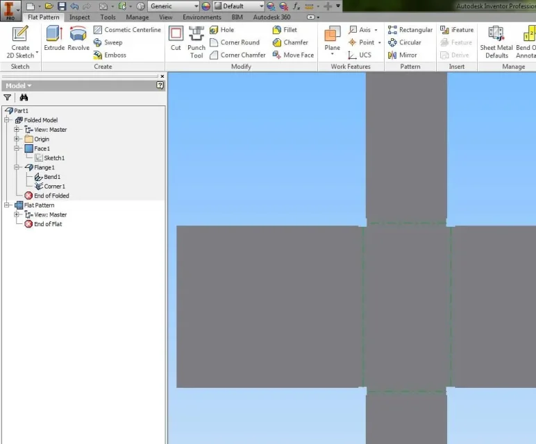

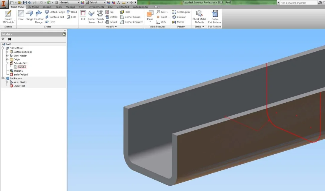

two stupid examples
the first done starting from sheet metal (scratch, create face, flange, sheet thickness and fold rules etc)
the second starting from a "normal" side sketch of the profile (with correct bending rays for sheet thickness), superextrusion of the sketch, thickness of the superextrusion, conversion in sheet, change rules thickness)1.webp
2.webp(although to be honest I make the precise quotas of the development make it to those who cut and fold the pieces, and the development I use it only when it makes me comfortable for some quotations of the work......... most times I quote the folded model......)

you have to shape your box, the development thinks inventor, you don't have to do otherwise, that is to draw your development and then bend it!
sheet metal environment.
a sketch of a rectangle.
set the sheet thickness you want.
face command and create a face with your sketch.
Flange command, choose the edges of the face you created and see what happens.
finally "flat model"
