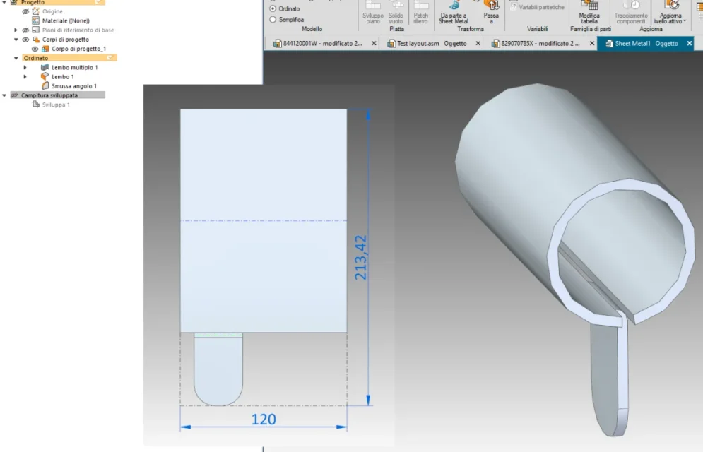

if I make the tube as sheet metal with multiple flap function, with a light of a few tenths, I get a developing sheet
I add a normal digging
I make the function flap and leave on the sides a light of a few tenths and get the tongue, remains to manage the size that covers quadi entirely the cut that can go to attempts or make an equation.
the pipe is however developable.

actually does it but with normal digging from error unscrupulous bodies1714394520499.webpit does with the size with the problem that the cutting of the development is tilted but this is the least considered that cmq to the laser you will have to decide if on internal or external skins.1714394630896.webp
mine is made entirely as part in a brutal way,
Extrusion pipe
cut cut
extrusion tongue with already rays in the sketch.
I don't have the file anymore, but it's really 3 operations.
the speech is that then from this you don't pull out your machine file, this is ok only graphically to show the operator how the finished piece should come.
Unfortunately I can't help you otherwise because I don't know what you have to give to the car.
But I'm almost certain that you don't have to give a flat figure like a development to your machine (but I might be wrong) and so I don't understand why to do it in sheet metal and then lay it down.
Perhaps it is better to explain to what final result you want to arrive and see which road to get there.
