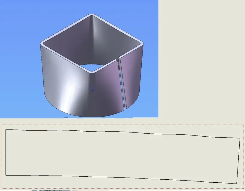

tangency is a compulsory prerogative.Okay, these stilts don't really want to know.
Then I have the solution, like the concept and everything.
Only problem I still have are the fittings in the sketch.
I mean, when I create straight elements, it tells me that they can have living edges, and I'll tell you, of course, but so I can't solve the loft, it won't.
Could you please help me?
This is the sketch I made.

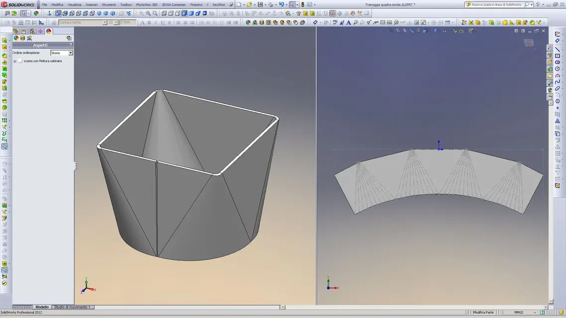

I should perform a hopper that leaves with a 50mm round and arrives at a 40x40 in a height of 30mm.
Yes, I did not do so otherwise he did not understand the concept. (I also drew a square reassembled. . )If not simpler, you need a diameter 200 mm, make a square with 200 sides, and connect all angles to radius 99, open one side to make the profile open.
already, this speech was one of the few things that really served me in the basic course of 1 year and a half ago:biggrin:Yes, I did not do so otherwise he did not understand the concept. (I also drew a square reassembled. . )
in the example posted is evident the non Coradial diametricity of the circle for the loft.
I, in my models, quote the straight line, which is what makes you the difference on
Good luck with the loft.
