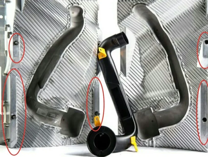

I refer in particular to blowing with extrusion and therefore mainly to monocavity molds. Generally this type of molds has a tracking surface for excess material no external reaction plans to prevent all closing force from unloading on the trancibave. Knowing the press closing force and the type of mold material, how do I know if the plans I entered are sufficient? I imagine that there is a calculation related to the "resistance" of the material, the closing force and the contact area of the two half moulds.

to avoid problems I uploaded a photo taken from the web, to closed mold will be in contact only the perimeter zone of the duct (tranciabava) and the plans I looked for in red. How do I know if closing the mold with 15 ton for example, my trancibava didn't collapse? If the mold was steel rather than aluminum could I reduce the planes? I would like to have in hand some calculation that according to this information you confirm that it's okay! S90710-134917(1).webp

I make my guess that can be corrected or not, you could measure the contact area between the two semi-stamps, knowing the closing force you can get the applied load for mm2 and see if you are within the limits of the material or not.

I thought of something like that, too! Whereas, however, as rp 260n/mm2 (I write numbers for example by considering an aluminum mold) and a closing force of 250000n I need an area of 960 mm2! practically with a 30mm square I did everything. correct me if I did something wrong.
