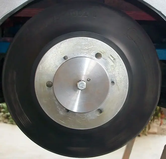

Hello everyone are new to the forum and I already propose you a problem: I have to design a rim, which will mount on a vehicle without motor, with gravitational propulsion, without shock absorbers, whose frame is completely made of wood... the mounted rubber is a full rubber ring, the total weight riders included is on the 220 kg... the rim should be made of aluminum, and using only the lathe, so I do not have the possibility to create races or things like that... and must be as light as possible.. the speeds of these means can also be quite high, about 110 km/h maximum... all the constraints I have written above are provided for by the regulation, so I can't in any way avoid them... Can someone tell me what calculations I can do to make sure the rim doesn't break? I do not have the measurements of the circle behind, but it remains small, I think 15cm in diameter or even less... the bearing that leans on the rim has external diameter 42mm seems to me... I thank everyone who takes the drink to answer. . .

You're right I didn't show up! However it is, it is means destined to downhill competitions then gravitational propulsion! I forgot that the brakes don't act on the wheels so I don't have any problems letting space to disk or similar calipers. I would just like to know what calculations allow me to size the rim so that it is safe... Hello and thank you. .

As for the rim, we would need more details (post some photos of these machines). you say the tire is a full rubber ring, the size is by regulation or can you mount what you want? diameters, thickness and tread width. then how is it fixed to the aluminum circle? enters by interference, is glued (type that of cars rc). You know we need some details to better understand. I have never dimensioned such things, but here in the forum there are very prepared people and with as much details as possible the answers that will promise you to be given will be more targeted.

I know they look like toys. but believe me a low order, the high rigidity gives these means a curved path outside the reach of a normal car... Every now and then we do tests with cars like 'opener' and we often have to stop to avoid dampering. . the rubbers have regulatory dimensions, maximum outer diameter 200 mm... those we use have a 75 mm ground footprint, while in the rear they are always of the same size, but double, coupled as in trucks.. currently the disk is composed of two parts that go to tighten the rubber, we have 3 screws passing that assemble the two disk means and tighten the rubber... Unfortunately at the moment I don't have all the measures, but as soon as I can take them and the places... the brakes are composed of a rubber skate that goes to the ground, downloading practically all the weight of the vehicle plus pilots on the ground, so the wheels do not have that stress. . the steering is very simple, takes into account the angle of hackerman and we can adjust the convergence, which normally is neutral... as soon as I place the drawings of the disks in section with all the odds, that I have at home... in the meantime, thanks to those who answered me and who will answer me;)
