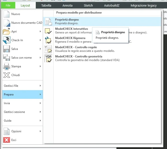

hi you have to check the settings of both the model properties and in the drawi g if you settatoble tolerances use and if the tables of tilleranza are loaded
Then:
options -> config editor and add tol_display and put yes
Then
- file-
-prepara -> design property
-Detail options -> find -> tol_display and setts in yes
Then
- file.
-prepara->standard tolerance -> changes in iso
-Table tolerance
-Recovery
- Fine.
to avoid having to make the changes that have been indicated you should use a standard iso.dtl that already contains all the entries set. however the voices are found here:
1674558141236.png1674558196779.png1674558834235.webpIt should generally be enough to allow you to view tolerances (of course they should be enabled on the odds you want to see them for).
the indications of tolerances should be placed in the dtl file that refers to drawing as indicated in the previous post but also in the prt and asm template that you usually use.
