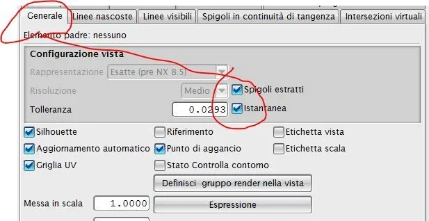

in nx9, to disconnect a view from model 3d, there is a flag in the settings of the view itself, called snapshot.
the active and the view disconnects.
I saw him. but if I enter the view expand that I did the snapshot and try to move a curve does not allow me and gives me the error "object supplied is of the wrong type". If I eliminate a curve there is no problem.
Do you have the flag of active association?
Hello, solved by gtac.
in practice the move of the curves or a set of them only works if the view is exact (pre-nx8.5) in the exact views only work the delete and sometimes the copy. I hope that siemens modifies the exact views so that you can work with motive even on those, since they are the last and the most performing ones.
