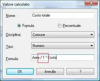

in revit, during the creation of fields calculated in the abachi within plans or formulas of control of the parameters within families, you may find yourself faced with a notice relating to "uneven measurement units"
es: area * cost
the solution is to change the formula slightly.
if you simply divide the area value for 1 revit will feel it as a normal wall parameter by eliminating the signaling of uneven measurement units while maintaining the correctness of calculations
