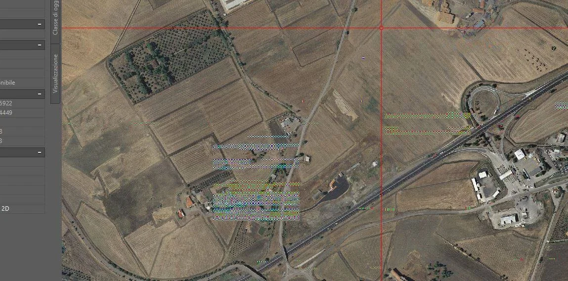

labland22 Guest Jul 28, 2017 #1 Save to all by uploading ecw from a while this display error appears to me, the rows move and resize as I zoom forward or behind. it also reports in print
labland22 Guest Jul 31, 2017 #3 PlannerRoad said: Try to install the latest autocad service pack? Click to expand... I installed all the service packs. I don't want the problem. I also updated video card drivers
PlannerRoad Guest Aug 1, 2017 #4 It is possible that the problem is due to the autocad service pack. this is the case of civilization 3d:https://forums.autodesk.com/t5/auto...-error-with-ecw-files-ortophotos/td-p/6739171and questo per autocad 2016 and 2017:https://knowledge.autodesk.com/supp...s-display-noise-in-autocad-2016-and-2017.htmlyou have not specified the version of autocad, in any case there is this hotfix indicated as well in the knowledge that I linked you:https://knowledge.autodesk.com/supp...c2-ae-autocad-c2-ae-2014-2017-ecw-hotfix.html
