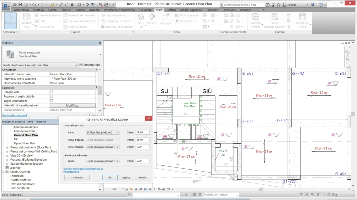

Good morning to all,
I have a problem with the viewing range in the first floor plan of an exercise I am doing.
I created, on the ground floor, a scale different from any of the 1st floor.
in the plan of the 1st floor unfortunately you see also the staircase below.
I tried to go to "visual/graphical replacements", but by popping up the various voices of "scale" I can't make it disappear.
I think I've been able to manage the "properties" range, but I'm probably wrong in something.
I hope I have been able to explain the problem correctly, some pious soul could help me, please.
Thanks always.
Does the structural plant look up or down? can you also post the details of the display range?

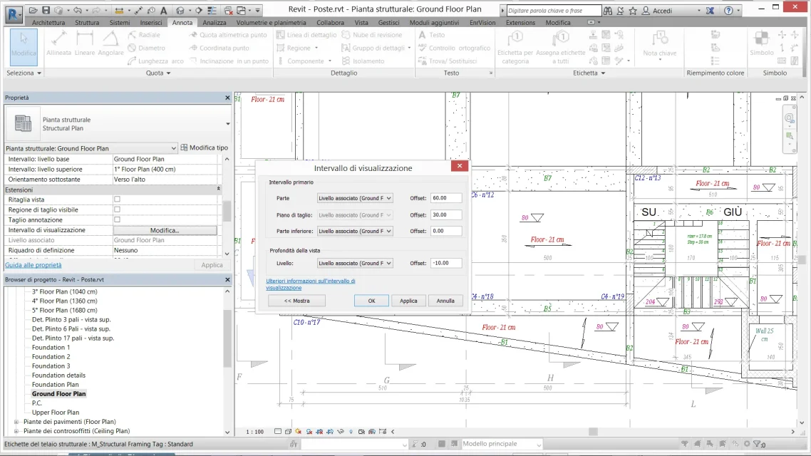

I do not see the display range values, but known (image 3) that you set the view "underside" different from nobody
Yes, in fact the three views represent the combinations of the various settings, which show how you can not remove the view of the scale below, the model is the same that I sent you, if you well remember.
Yes, I just tried it, but turns off the scale of the plan that I want to show in planimetry and leaves the staircase below, which I don't want to show
