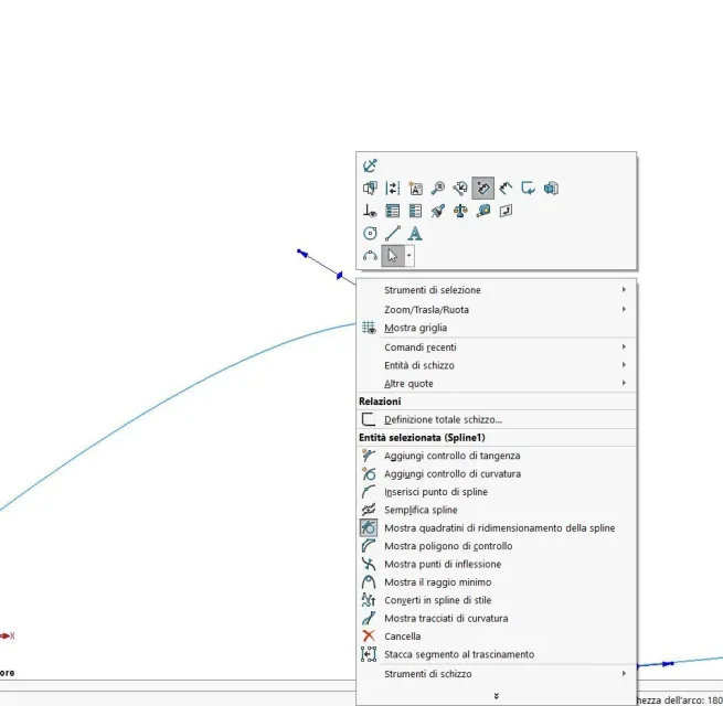

Hey, I got the same problem. I have always changed the spline with the handles, but now they are no longer visible from day to day. If you were able to solve it, let me know.Sline.webp

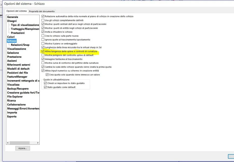

Hi try so select the right button spline pops up the image menu select the button indicated in the image if you try with the second image
