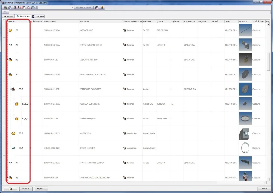

at the moment I use the distinct inventor components to export in csv format the distinct of my assemblies (I carry structured list with all levels ) and then import them into the management .
As long as I take and amount the first time everything works, the problem is when I change the set (by adding or eliminating components ) and the amount (I use the number of item to compare the distinte , but inventor assigns the value of this number with a criterion that I can not control therefore between the first and second extraction the same component can have no different element and this then kicks all the distinct .
I accept any suggestion to be able to export reliable separates .. account on you .
Immagine55.webpThank you.
personally the 1st thought is to compare the n° part or , even better the file name that, surely they are unique.
in the application I used, it worked like this:
import into management was via 2 shields.
the 1st, comparing through the code (part) the presence of the analogue in the management; if , the analogue was not present in the management was created, compiling fields such as code, description, material, color treatment.
the second screen created the distinction through the parent-child bond between the different levels of distinction exported by inventor
In the meantime, thank you, but still a question, if you had to export an existing distinction that was going to happen, do you overwrite all the lines?
si, or venivva put in rev_1 since the management managed the revisions of the teaching staff
