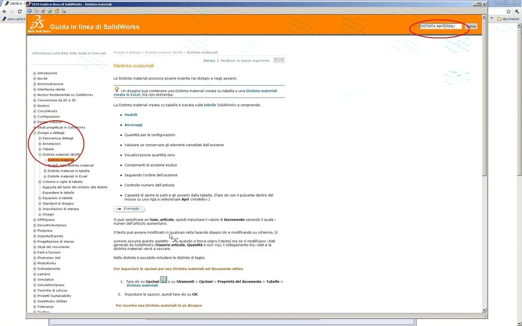

DISTINTA MATERIALI.webpan extract of the online guide; follow All paragraphs and links, you will see that it is easier to make than to say/explain.

I followed that guide but as I repeat it does not automatically put the data, all remain empty, puts only title and quantity.

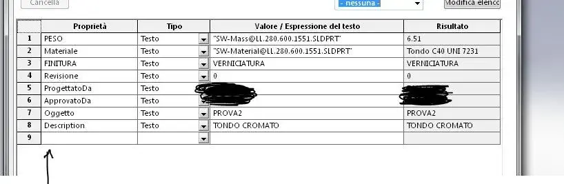

in the list of elements of the environment part - welding have you put for each element the properties you want and want to appear in the table automatically?
the names of your columns must then be connected to the custom property of the part document.
dx key on the item: element list - updates and the "solids" are grouped with the same geometric characteristics.
edit : I read now that you want it from the environment together. Right? therefore a distinct materials and not cutting ...
then... in the properties of the assieme - subassieme - part - you have to fill out the fields you need for the table.
you put weight : description ( or description ) - material - length - cost etc.

in the table/distinct you can add/rename all the columns you want (works like a excel sheet). each column refers to a property of the part file (which decides and checks you). of course you must have assigned to the part all the properties you want to see in distinct.. quantity and file name always see them because if you charge them automatically (it can do it because they are not variable) but the other things you have to tell them.
from side documents choose file > properties and fill out the table that shows you. those voices you can then call them back in the distint of the axieme; click on the columns you will see your list of properties.
make a table as you like, save it and you will always have it ready and self-compiling. even in the template files of parts and assemblies (templates) you should have saved your list of properties, so you should not have rewrite it every time.
I told you, it's easier to do than explain (even because it gets long). read well and all the guide and do some evidence. but you have to prepare the correct "environment", the program cannot know what you have in your head.

I corrected it.
the chapter of the correct guide should be this:
