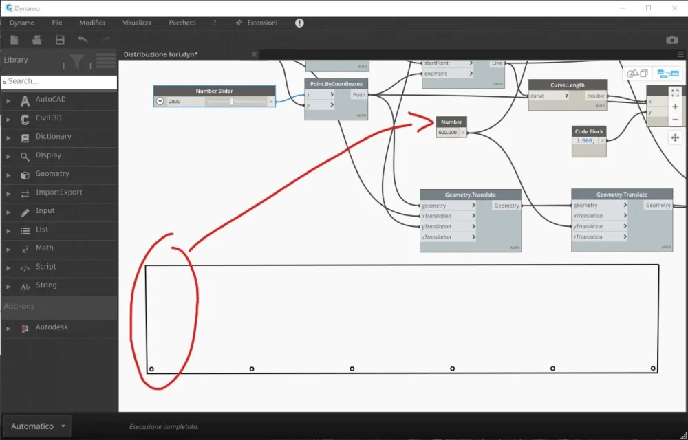

I have a parametric block that should represent an alucobond panel, and since I have 100 thousand different sizes, I would like to find a solution to the distribution of mounting holes arranged symmetrically, for each different size of the panels.

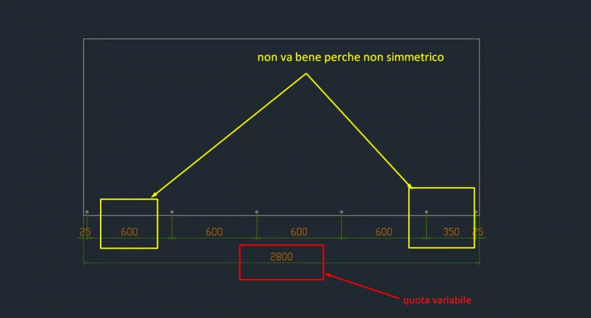

we have a panel of 2800 mm long, to be drilled with the first and last hole with a distance from the edges of 25mm and a maximum hole interaxis 600mm between one and the other.
the block I created it with a "linear parameter" that takes all the length of the panel and a "stira" action to modular it in length.
the holes instead I used a "series" action on the "linear parameter" mentioned above giving a maximum distance between the columns of 600mm.
the problem arises when the interaxis of the holes are not submultips of 600 and the last hole is different from that of the first. in a few words I do not have centered and symmetric holes.
I attach files to better understand my problem.
is there a way to reproduce this?
