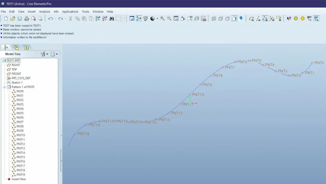

you start from this station as from image.
the purpose is to tie those points with linear curves and not spline. Curved arrival will be the beginning of the other and so on.
condition is that the generated curves are equal in length.
Any idea?
the solution that comes to mind is to use balls together and then transfer the result through the copy geometry:
- I'd like a date.
- part will be the curve
-model a known diameter ball with a point in the center
- insert the first ball into one of the ends of the curve
- insert the second sphere with the center on the curve and tangency between the 2 spheres
-continue to insert balls in this way until the end of the curve
- If the number of balls is too low to get to the definition level you want, reduce the diameter and add other balls
-When you have the number of balls that hold you, insert a blank part and with the copy geometri, you copy all the center points of the spheres.
-the resulting part, you can connect it with segments that will be by force of the same length, equivalent to the diameter of the spheres.
It should work.
