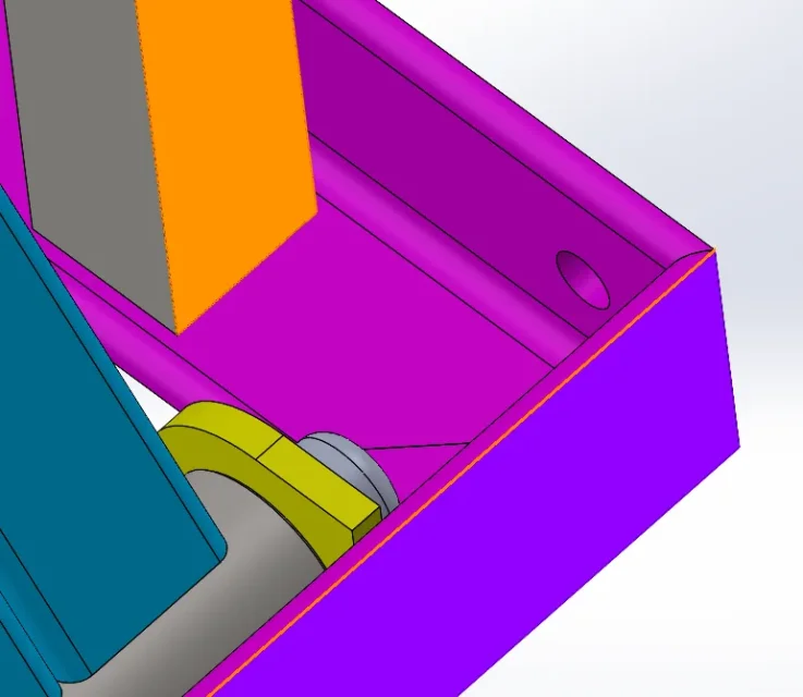

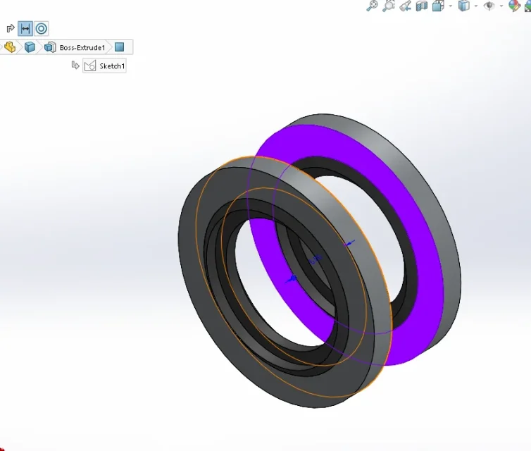

Hello, everyone. I'm having a problem that I can't fix. I created a set containing various parts, including some of these parts have the "distance" mating bond. If I go left in the mating section and click on the distance I appear in the axieme. in blue, the share I put. only that some distances this does not happen and does not allow me to change the quota, but I must necessarily click in change function. This is uncomfortable if I have to write a relationship with this distance. I attach photos maybe you understand. I hope there is a solution. Thank you very much.

try to select only one oject that has the coupling and click on the icon...it should appear.1708523077647.png1708523103117.pngSometimes when you have multiple couplings on an ogetto, it doesn't measure you.
