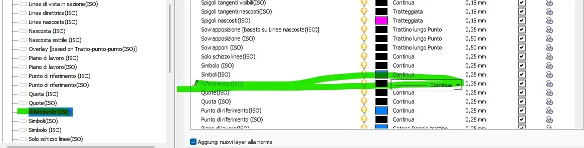

Hello, of a .iam group I put as "referral" the components that make it .. because I do not want the distinct base .. only that in the table 2d the lines of these objects are dotted. ...
How can I make her look continuous?
in the idw file. go to the broswer find the dx key element. selection as edges and then property and then you can change the line type
if you want a permanent job works on the template, from "editor styles" goes on "layer", then "reference" and from the value you want, then color, type of line, thickness etc.
double click on view - model status - display style "spigoli as part"
I changed the line... but how can I apply it by default on all the drawings I open?
